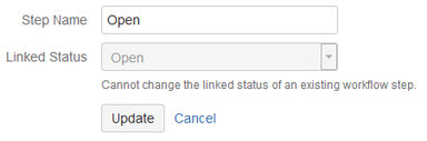

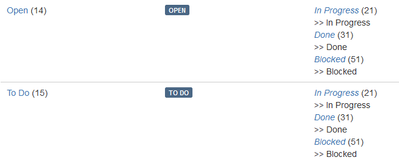

When I add a new step (e.g "to Do") here:
I get:
In this workflow all steps follow the same transitions. New step automatically has the same transitions. Plus, when I try to edit the transition, I get:

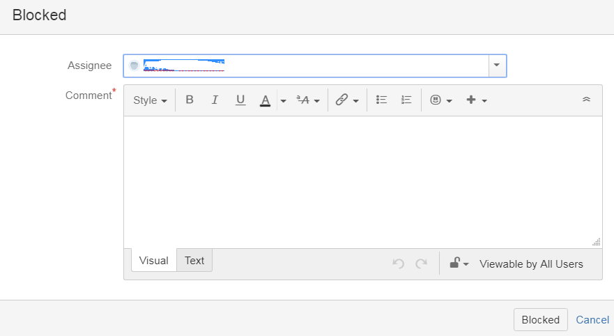

Here is what I need:
When I move from open to blocked, I need a window to pop-up (the last picture I sent) that asks for a comment.
Now, when I try to execute this transition i get this error message:
"Comment is required.
It seems that you have tried to perform an illegal workflow operation.
If you think this message is wrong, please contact your JIRA administrators."
Thank you!
Nic Brough -Adaptavist-
February 13, 2019
Ok, from my standard copy-and-paste for transition validator and screen:
  • one of your admins has placed a "validator" on the transition that makes the comment required during the transition
  • one of your admins has removed the transition screen from the transition (probably a different admin), or the workflow was designed without one
In your question, you've stated the first line applies, and I now understand it properly.  Thank you for clearing it up for me, I was struggling (think I was having a bad day).
It's the second one we should fix here.  Go to Admin -> Issues -> Screens and add a new screen.  You don't need to put any fields on it at all, although to match your screenshot, you should add "Assignee".  Give it a name like "assign and comment"
Now edit the workflow, find the transition and add the screen to it!

Thank you @Nic Brough -Adaptavist- ! Adding a screen was the solution! :) :)

In order to make your changes you'll need to create a copy of the workflow you want to edit first. You can them make the amends and make this new workflow active and delete the old one. When you make the new workflow active you can map tickets to/from and new/old statuses.

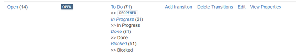

I've made a copy of the workflow, but when I try to delete a transition
of this one, for instance:
I am not able to delete all the transitions I need. I only get the transition I've just added:
January 7, 2019
The other transitions are listed in italics in the text view of the workflow because they are shared transitions.
That type of transition can only be edited from the diagram view of the workflow (or the raw xml)

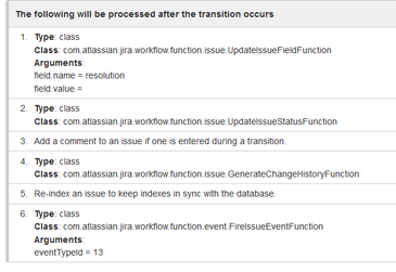

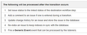

Hi again!
I created the new steps and transitions from the diagram view.
Then how can I modify post functions?
Some of them are created automatically and it is not permitted to change them.
For example, I'm getting these post functions:
But I want these:
Thanks in advance,
Iro
January 22, 2019
Actually, only line 1 in the second screenshot is different.  On most transitions you need the 5 standard post-functions that the system adds for you (the exception is "create") - set status, comment, history, re-index, fire event.
To add the resolution function on the first line, go back to "edit" mode for the workflow and then back to the list of post-functions.  Look to the right of the "the following will be processed", and hover the cursor, an icon for "add post-function" should appear.
