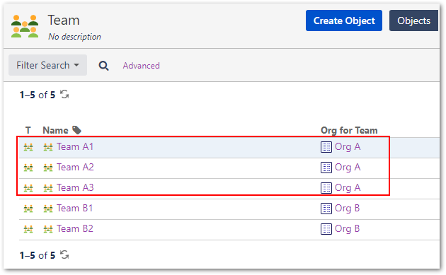

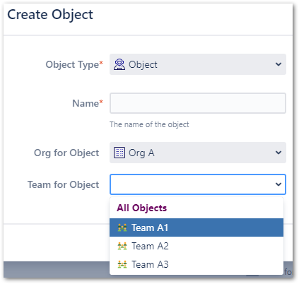

I set up a sample schema with 3 object types: Org, Team and Object
Team contains an attribute called "Org For Team" that is a type "Object" and points to the Org object Type.
Object contains both an "Org For Object" attribute (same as above, type object and points to Org) and a "Team for Object" attribute (type object and point to Team).
The "Team for Object" has the following IQL in the configuration "Filter Objects"
"Org for Team"=${Org for Object}
The ${Org for Object} refers to the item selected while creating the new object. This is then compared to the "Team" attribute "Org for Team" and the filter renders just those teams.
Which you can see is a subset of the Teams:
