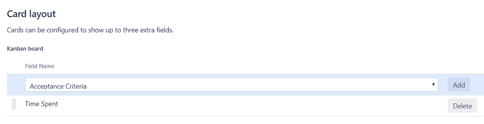

Hi Fred. Did you go into Board settings > Card layout and add Time Spent to the card layout?
Hi Jack, yes I did go the card layout field and add Time spent. But when I go to the Kanban issue/card i don't see the Time spent field.

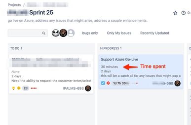

Fred, i'm a bit confused. The card layout is for the card in the Kanban. The second image is the detailed issue view. For example, below is an image of a Kanban board that is showing time spent.
