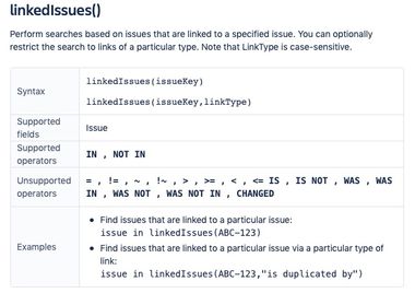

i was just checking the documentation and found the following so my previous response may be dated. Can you have a look at below and the docs? Note the above link is for Server 8.1 please be sure to select the correct platform/version for your instance.
Julie R. Whittington
June 24, 2019
Thank you for your help. I will need to look at that section further on how to create the syntax that will pick up all the cloned issues per epic.
