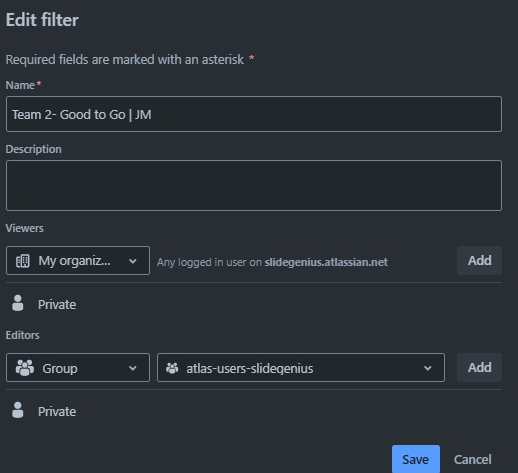

Hello,
I'm creating a dashboard, when I set the viewers to "My Organizations" and save the created dashboard, the viewer's set is "Private". I keep repeating creating the dashboard, but the viewers are always set to "Private" when I try to place it in "My Organizations".
I'm the admin, but I'm having this kind of issue, can someone explain why this is happening?

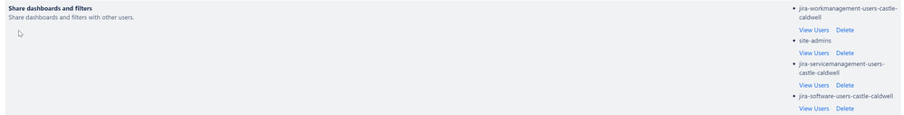

Couple of things to check -> If you create a filter, can you share that with your overall organization? If you can't, you probably need to check the "Share dashboards and filters" Global Permission.

If both Filters and Dashboards do not let you share them, then your problem is with that global permission more than likely.
for the filters, I try also to change the viewers to "My Organizations", it keeps going back to "Private" whenever I save it.
this happens also when I try to edit the dashboard
When you click "Add" to that for the organization and then save, does it give an error?
None, but it keeps Private whenever I add it.
And for the Global Permission, I'm one of the site admins.
Ok, being a site-admin if you don't have the permission can still result in being unable to share.
I just kind of tested through a situation where I removed my permissions and I can't even see other bits to share to if I'm locked out.

what kind of permission do I need to have that access??

So need to be in a group here:
But given what you are showing me, you are in a group there. If you didn't have the share permission you wouldn't see anything in the drop downs at all.
If you go select "My Organization" -> Click "add" -> you see it swap out, but when you save it it doesn't save and reverts back to private, and you have those share permissions, something is wrong and I'd open a ticket with support, because either something else is wrong or something in your browser is doing something. I would include the things you've checked with support and any kind of a screen recording of it happening.
