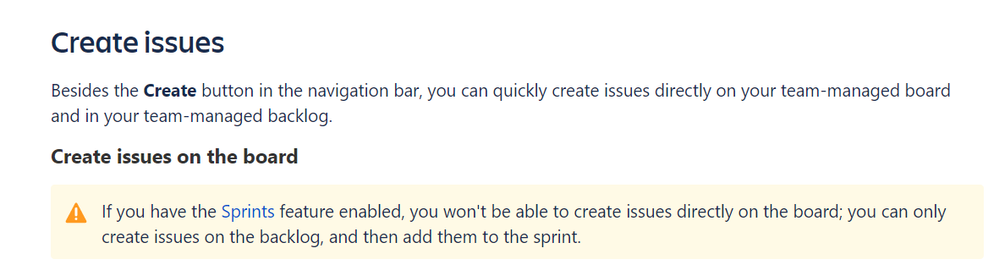

Hi @Eli Blitz
Here's the reference
It is only available in Backlog Page
https://support.atlassian.com/jira-software-cloud/docs/get-started-with-team-managed-projects
In Kanban board you will get the Create Issue in To Do Sections

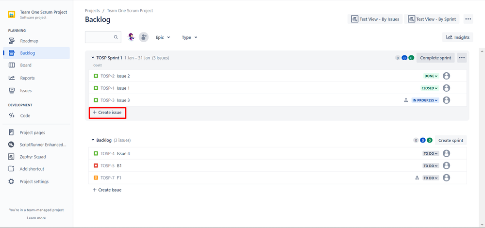

As of now, there is no feature to create the issue directly from the Sprint board.
Issues can be created from the Backlog as I have shown in the Image

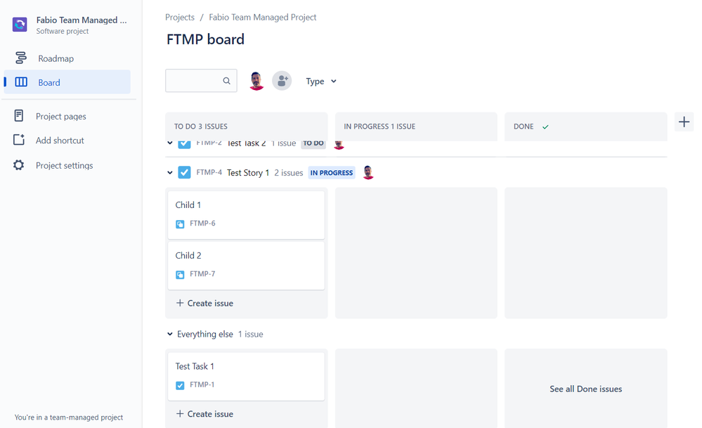

Hi @Eli Blitz ,
welcome to the Atlassian community!
Please verify that you are administrator or member for that project. If you are a viewer you correctly can't create issues.
If so, create issue should appear on your board :
Hope this helps,
Fabio

ok @Eli Blitz , so you should be able to create issue from a backlog and not on the sprint status view
