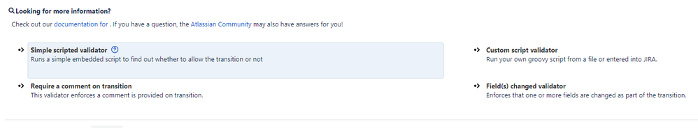

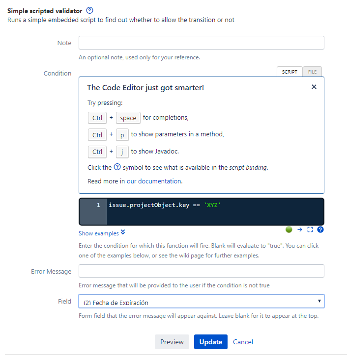

Fran Garcia
November 8, 2019
With scriptrunner you can make a validation depending on a condition.
