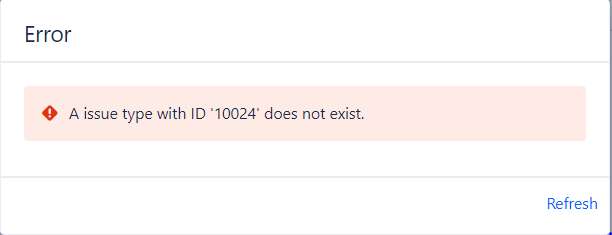

I seem to have a problem with one particular workflow, the one that has some 400 projects associated with it, of course.
I need to assign a new issue type to this workflow scheme.  Yet I get the error message below, with the same issue ID regardless of which issue type I try to add.

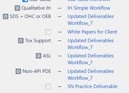

Also, when I am looking at "workflow schemes" there are some workflows that aren't associated with any issue types, because I deleted those issue types (e.g., we used to have a white papers issue type, which I've deleted because we don't use it anymore, which is still mapping to the whitepaper workflow).
If I try going to "edit" to remove the issue types from the workflow scheme, they don't appear on that list.
When I go to "workflows", the white paper workflow still appears as active and assigned to the malfunctioning workflow scheme, even though there are no projects using it.

Can't you COPY the schema?? Then you'l find it under INACTIVE schemas at the bottom of the page and you should be able to edit it no problem since it is a new, unassociated, scheme.
Then you'll have to manually assign the new schema, I'm afraid... Sadly, I don't think you can assign that new schema to each of your 400+ projects in bulk, at least not natively, but at least you can fix the errors.

I can copy the scheme, but it copies the bug with it.
Since posting this question, I have been in touch with Atlassian support, and they have confirmed that it is a known bug that happens if you delete an issue type without disassociating it from the workflow first.
They are helping but it is requiring some effort as I have approximately zero coding experience.

Sorry to hear that. I was hoping that maybe you coud edit the copy and just remove from the scheme the workflow associated to that deleted issuetype.

Update: it turns out I cannot edit anything at all on this particular workflow scheme.  I tried to add a description (so people would know it wasn't working properly) but even trying to add something to description field returned the same error.
