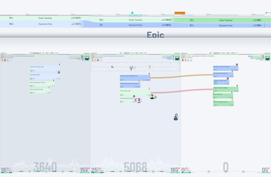

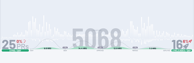

Screenshot 2026-08-13 at 11.48.39 AM.pngScreenshot 2026-08-13 at 12.18.49 PM.png
Everview (demo data): delivery health for one iteration, read from GitHub — PR flow, DORA signals, and where PRs stall.
Small easter egg: that lines-of-code skyline behind the panel isn't random the bars are drawn from the Seattle skyline!
Feel free to poke at it on the Atlassian Marketplace: Everview.ai
