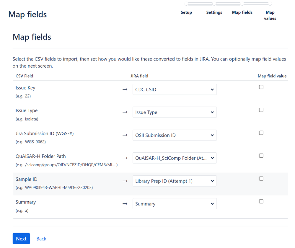

These column names are matched to identical Jira field names in the import mapping? Can you provide a screen image of the field mapping screen?
  • Sample ID
  • Jira Submission ID (WGS-#)
  • QuAISAR-H Folder Path
  • Summary
  • Issue Type
Derek Colanduno
January 2, 2024
Below is a screenshot of what we are trying to do when we import.

Thank you for sharing that screen image. That is helpful.
Are you importing to a Team Managed project or a Company Managed project?
I see in the screen under "Issue Type" on the left it says "(e.g. Isolate)". Is "Isolate" the name of the issue type you are importing? Is that the only issue type value you are using?

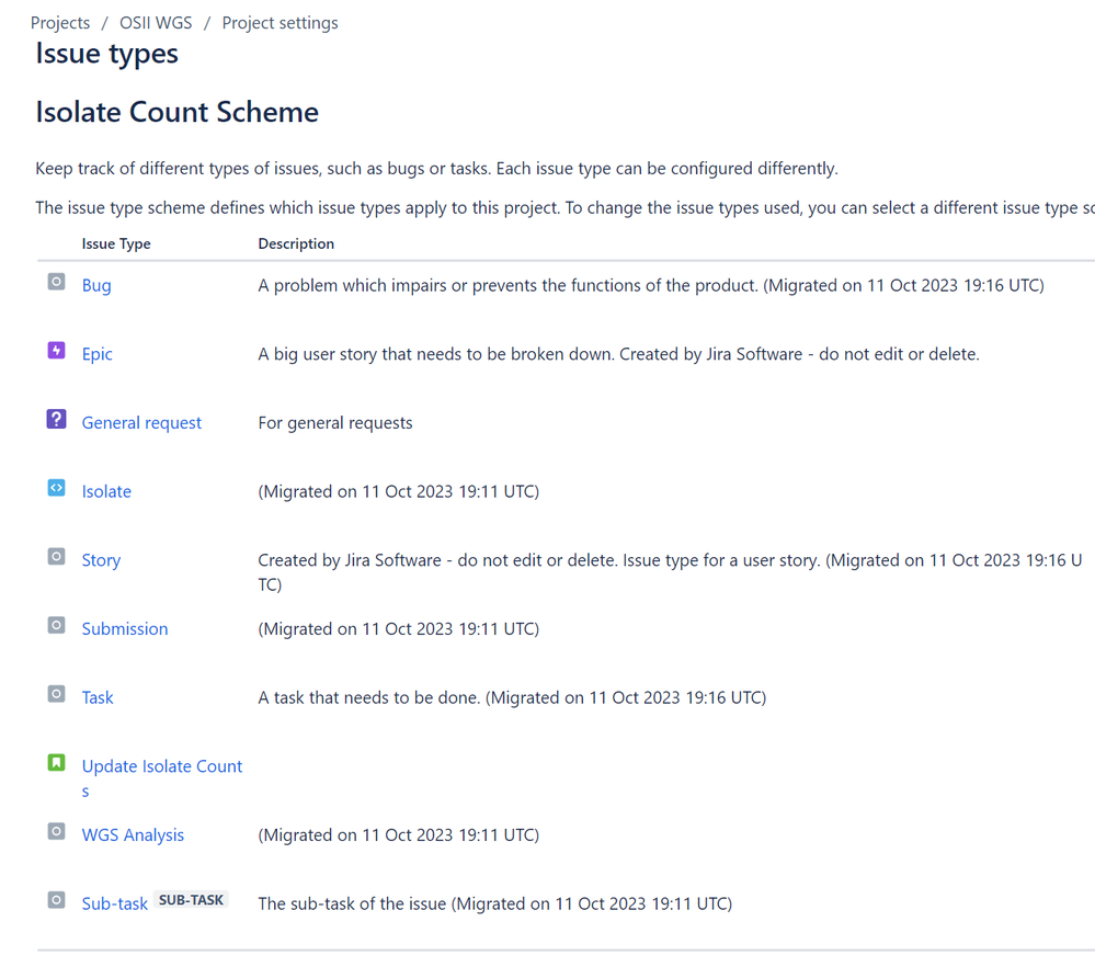

Can you show us a screen image of the Issue Types available in your project, showing the issue type category each is in? For a Company Managed project that would be an image of the Issue Type Scheme. For a Team Managed project that would be the image of the Project Settings panel on the left after drilling down to the Issue Types. Please indicate which issue types are included in your CSV.

Thank you for sharing that. That confirms that "Isolate" and "Submission" are not Sub-task issue types.
I am not seeing anything obvious to account for the issue. I will need to do some experimentation of my own in my own system to see if I can recreate the problem.
