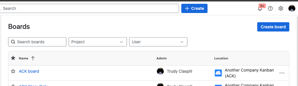

Are you accessing the Create Board option from the Boards list?

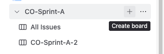

Or are you accessing it from the + button next to a project name in the navigation panel on the left?

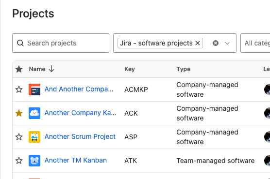

If you go to the list of all projects (through Project > More Projects > View All Projects) and filter for Jira Software Projects, in the Type column do you projects show that they are "Company-managed Software" or "Team-managed Software"?
When you go through the Create New Board dialog and elect to create a new board based on an existing project, the project list presented will include only Company Managed Software projects at this time
