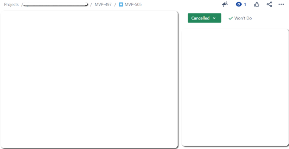

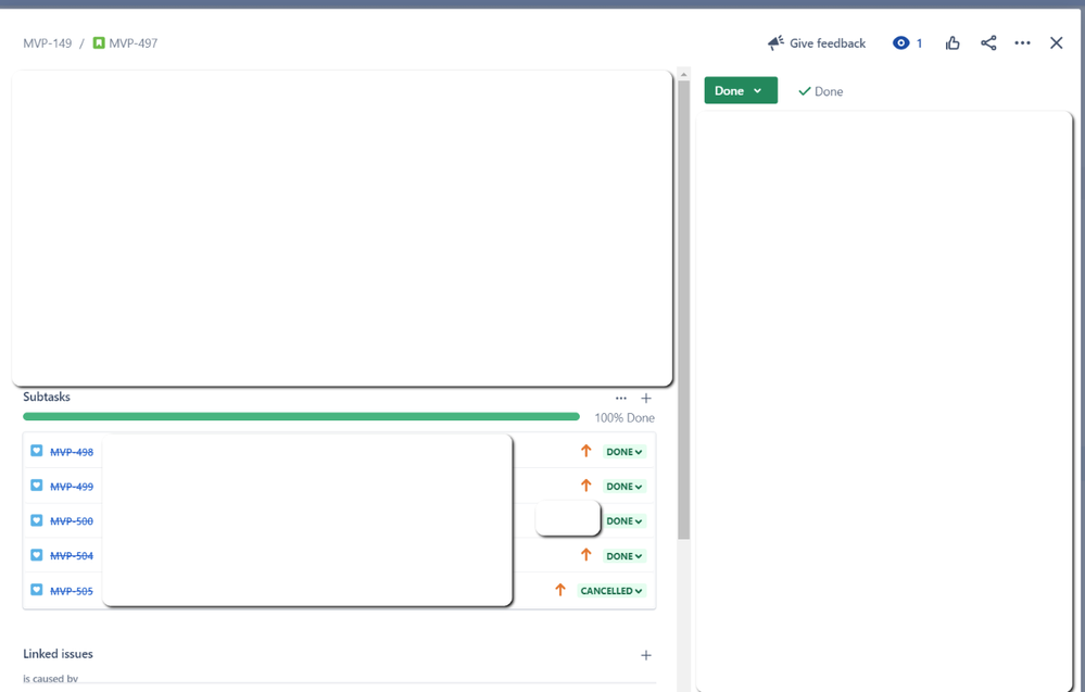

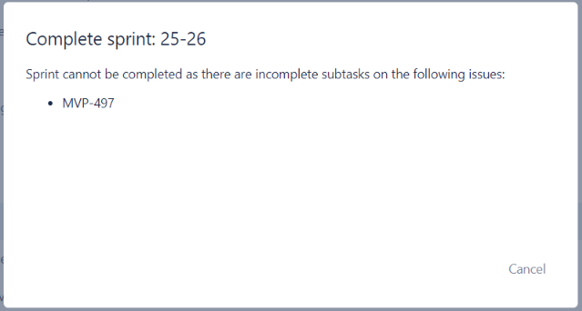

Extremely frustrating, I'm now blocked again from closing the sprint because there is a task that has a subtask which has cancelled state :/
Jack Brickey
July 5, 2021
Is “cancelled” status in right-most column?

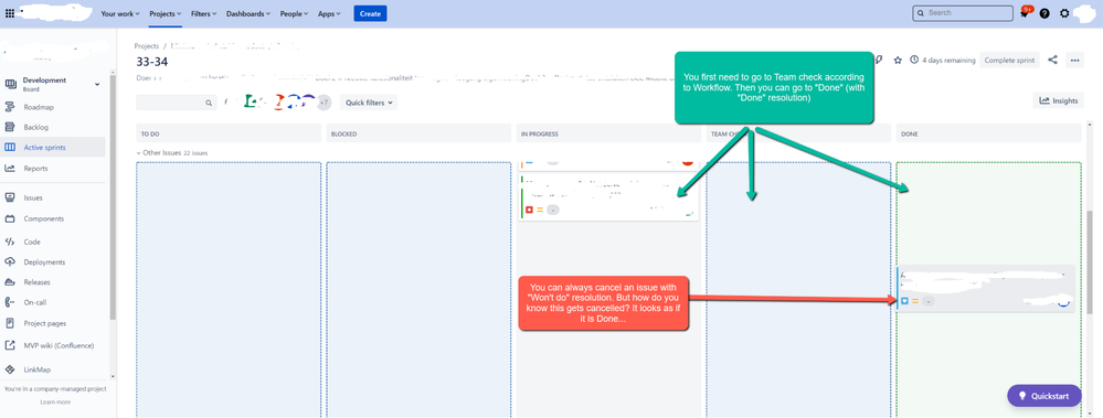

This is working horribly. I have so many developers just cancelling stuff... Let me show you where this goes wrong:
Jack Brickey
August 24, 2021
Done in scrum or Kanban is the right-most column always without exception. If you don’t want “cancelled” to be a Resolution value for a Done status the then you can have a Cancelled status of type Done status category. You just need to be sure to map Cancelled status to the Done column. Finally if you don’t like Cancelled to appear as Done then rename the last column to something else: Complete, Addressed, Nothing Left To Do, Abyss, Fred…..
