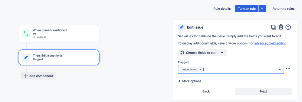

Automation to flag the issue

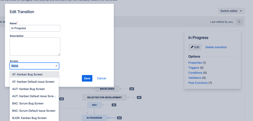

Now for the pop screen
- You may create a new screen
Add a screen
  1. Select  > Issues.
  2. Click Screens > Add screen.
  3. Add a name and description that describes when this screen should be used.
  4. Click Add.
Now in this screen you must had the 5 fields that are need to be filled
Now add this screen in the transition where they need to be filled, In my case it would be in progress, Publish the workflow

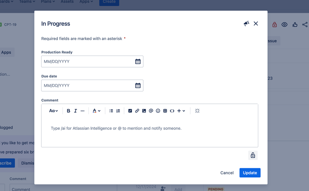

So here when a user transitions the issue to in progress automation will take care of flagging the issue and workflow of popping the fields
