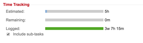

If you plan to set things up like this, best practice is to include estimates only on the parent issue and not on the sub-task issues.
In the Time Tracking section of your parent issue's detail view, check the tick next to Include sub-tasks as shown below:
hours logged on subtasks will be shown here then.
You can also use the Sum of Time Spent column in Jira's issue navigator to display this information in overviews:
Also, have a look at this related question for a bit more background.

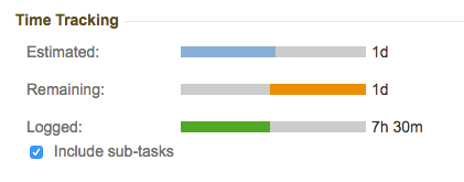

Thank you for your response. It's helpful to know that the approach you describe is considered to be best practice. I considered that approach (I tried all combinations of including or not including estimates on the parent issue and the sub-tasks), but thought the Time Tracking display was confusing.
In our case, hours will only be logged on the subtasks, not on the parent issue. This results in the Estimated and Remaining bars in the Time Tracking display being lengthened with gray bars that represent the hours logged on the sub tasks, but more importantly, the Remaining value that's displayed remains at its original value, suggesting that no hours have been logged against it. The only way to get the real value for hours remaining is to subtract the Logged value from the Estimated value in your head.
In the screen shot below, the estimate on the parent issue is 8 hours, and there are two sub-tasks that have a total of 7.5 hours logged on them.
We may need to go with this approach, but it'd be much more desirable to see the Remaining value and it's bar in the chart decrease as hours are logged on the sub-tasks. Possible?
Many thanks,
Dave
