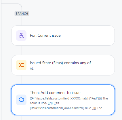

@Jehan Bhathena Thank you for the quick response on this!
Unfortunately, I was not able to get this to work. I am fairly new to smart values and think I may be doing something wrong.
This is the error I am receiving:
This is how I set the comment in the rule:
{{#if (issue.fields.customfield_XXXXX.match("Red"))}}
The color is Red.
{{#if (issue.fields.customfield_XXXXX.match("Blue"))}}
The color is Blue.
{{#if (issue.fields.customfield_XXXXX.match("Green"))}}
The color is Green.
For the issue, I ensured that 2 selections were included in the custom field when testing.
Do you see anything quickly that may be incorrect?
Thank you!
William

Jehan Bhathena
January 30, 2024
Hi @William Wightman ,
The syntax for the custom field was incorrect (my bad)
https://community.atlassian.com/t5/Jira-Service-Management/how-to-add-Custom-Field-Smart-Value/qaq-p/1976220#M100981
Try using this : (customfield_XXXXX.match("Green")).
I would also suggest using the action "Log Action", and print the value that is stored in the above field eg.
{{customfield_xxxx.value}}
Reference : https://support.atlassian.com/cloud-automation/docs/find-the-smart-value-for-a-field/#Testing-smart-values
