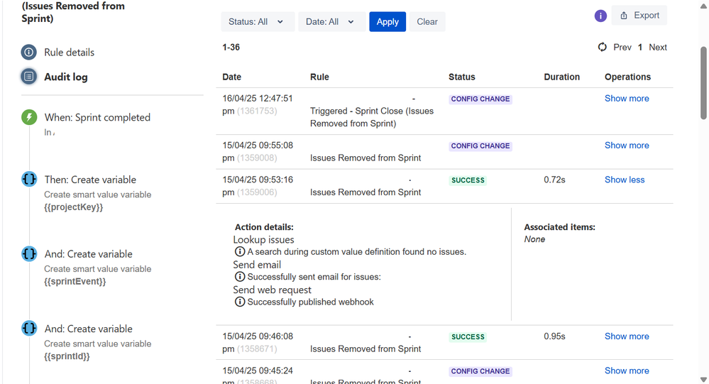

No results are returned when the automation fires based on a trigger (eg Sprint closed)
Results are returned when scheduled and manually triggered. This, unfortunately, means I need to update the sprintId variable and manually trigger at each sprint close.

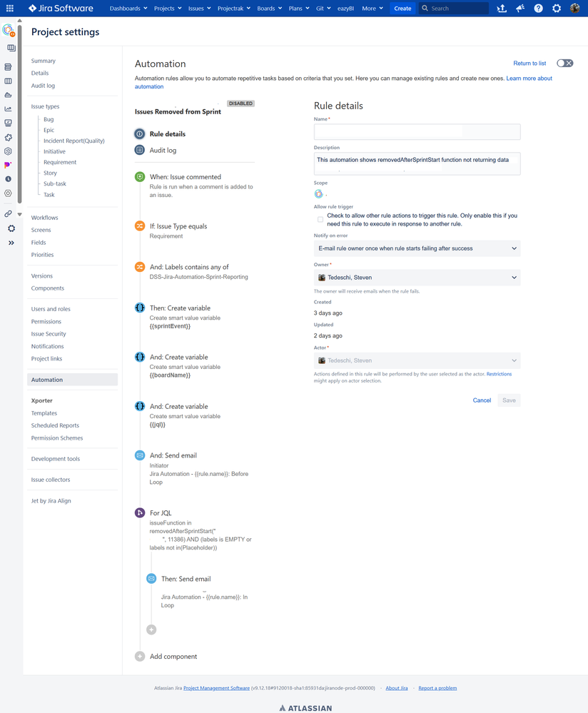

@Trudy P Claspill Sure - please see attached

Thank you for that additional information.
You said that your rule was triggered by an event like Sprint Closed, but the rule image you shared does not use that trigger.
Can you share images of the rule when you use that trigger, and the output in the rule audit log when such a rule executes?

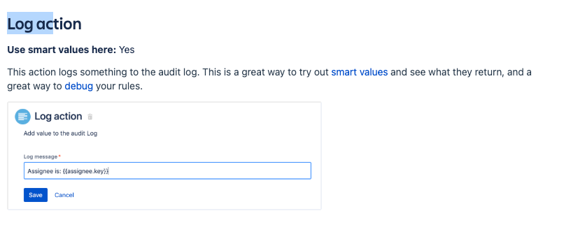

I would also suggest that you should add Log actions to print into the rule audit log the value of each Variable that you created to confirm it has the value you think it should.

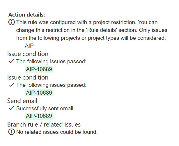

  • Trigger: Yes, the original automation was triggered by the sprint close event. I originally thought it was a timing issue and switched it to be triggered by commenting on a specific issue (also easier to test / trigger the automation. Here is the original rule and log. You can see that search result was empty.

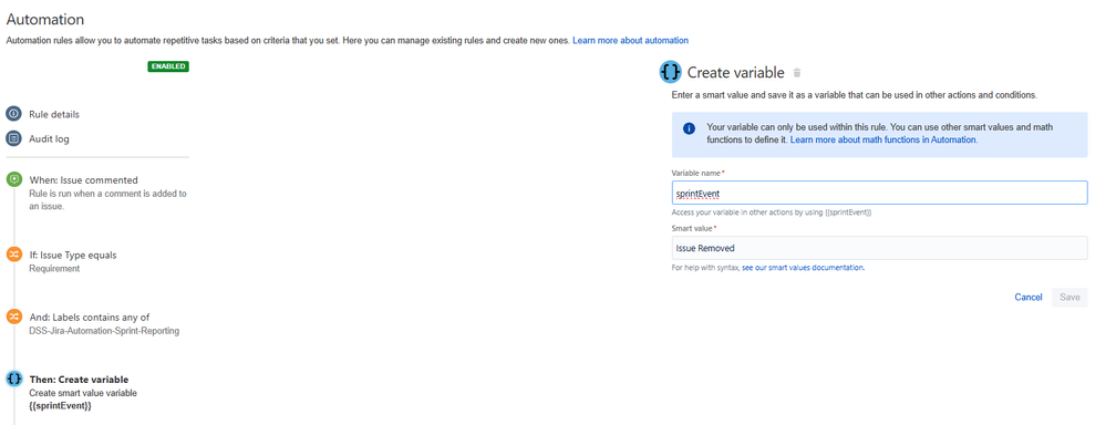

Can you share the details of the Create Variable actions, so that we can see what you are using to set the variables?
I would also suggest that you should add Log actions to print into the rule audit log the value of each Variable that you created to confirm it has the value you think it should.Screenshot 2025-04-21 at 9.01.35 AM.png

Originally tried to do numbers 2, 3, and 4 in one automation, but was only getting data for the first "event" (#2). That automation has since been broken into 4 separate automations, each focusing on one of the four events listed above. Since the first two are triggered when a sprint starts / completes, the jql (details below) doesn't include an issueFunction and return results as expected. Originally tried triggering numbers 3 and 4 on sprint completed event, but the results were empty. I have cloned the automation and triggered it by commenting on a specific issue for easier debugging.
sprintEvent:
  1. Sprint Started
  2. Sprint Closed
  3. Issue Added
  4. Issue Removed
