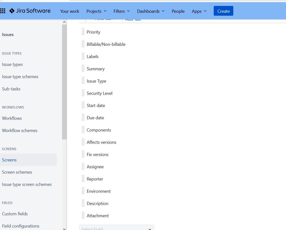

Thanks for your response! I got to the issue type screen schemes area and altered the default template, and the changes are reflected there, but when I create new projects they don't have these options included, and it's just the original settings again. How do I get these changes to take affect on new projects or across current projects?jira1.jpg

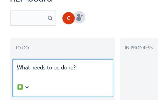

Even small changes applied within the projects don't seem to apply, for example, adding "task" as the default but "story" continuing to appear firstdefault.jpg
