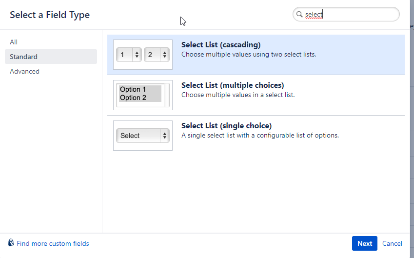

Hello @Kelly Genova
Did you check the select list (cascading) cutom field. You can have a parentoption and childoption. But the values are static.
Hope this helps
Kelly Genova
January 30, 2020
I do not see that option. Can you tell me where I might find that? I should mention I am using version v7.13.
Mohamed Benziane
January 30, 2020
go to the panel administration, click on "issue">custom field>add custom field (selecting list (cascading)

Kelly Genova
February 7, 2020
Perfect! Many thanks Mohamed.
