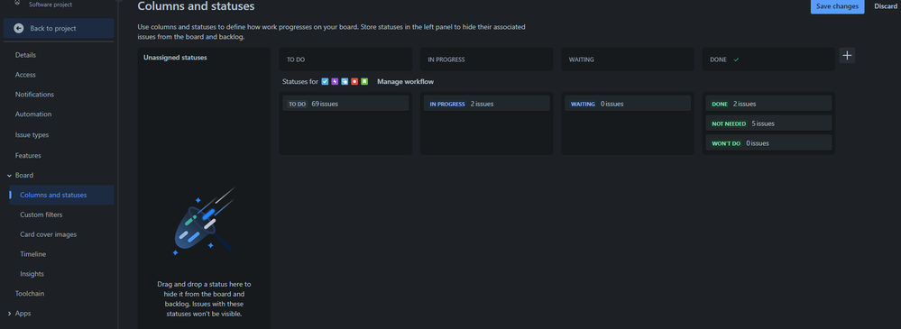

Never mind, I just wasn't aware that you could put multiple statuses in one column - see the DONE column in the image below. This fixes the issue.
Just go to Board
Then Configure Board (which you can find under the ... menu)
Then you can do this:
