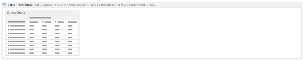

Wrap your Jira Charts macro in the Table Transformer macro:

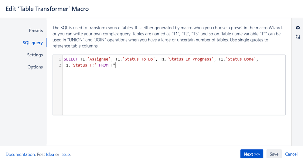

And list the columns as you need with the help of a custom SQL query.

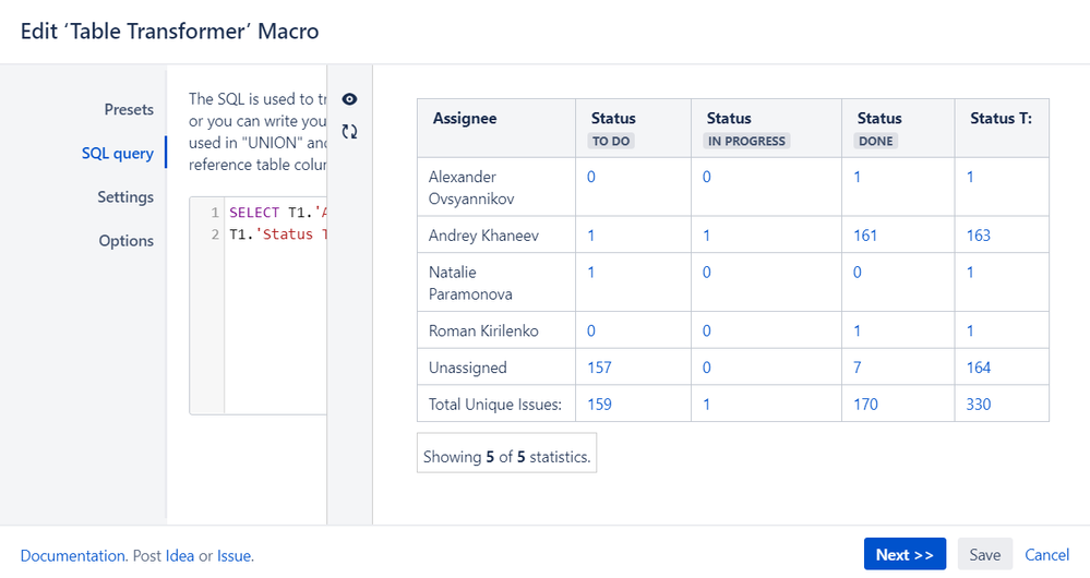

For example, I've used the following query: SELECT T1.'Assignee', T1.'Status To Do', T1.'Status In Progress', T1.'Status Done', T1.'Status T:' FROM T*

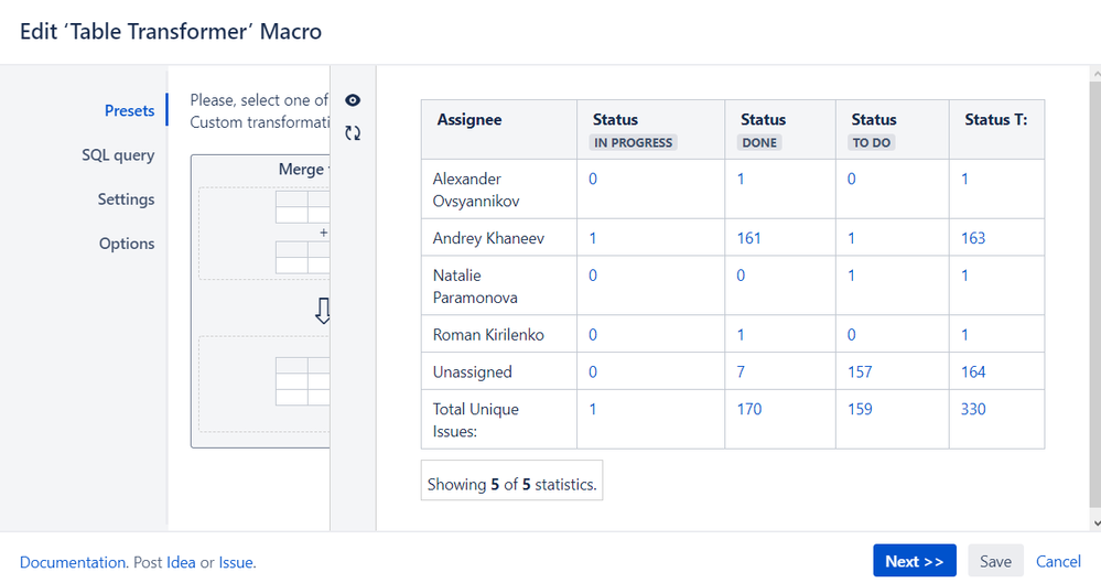

As you can see, the column order has changed:
Hope this helps your case.
