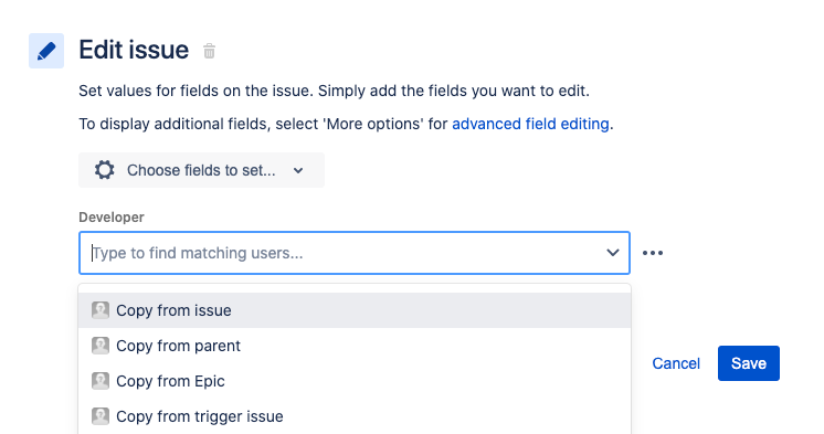

Hi Martin, thanks for the clarification regarding postfunctions. Seems like I have to be an admin in order to configure workflow, which is not possible to obtain from my organisation at the moment. Are there any alternative way around this? I tried to use the automation function, but there is no option to copy the assignee directly to the developer field (there is limited options e.g. in the image attached).
There is an advanced option that requires some coding, could definitely use some help on that if you are able to advise.Screenshot 2020-10-19 at 10.36.01 AM.png

I am a novice at JSON, so this is currently blocking for me. If I could ask for a script that would allow me to copy the user in the assigned field to a custom field (developer), it would be immensely helpful.
