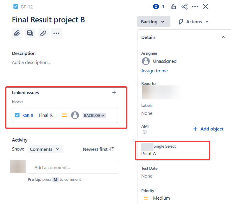

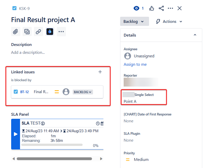

Hi Team,
 I have a requirement to show a "single selection custom field" value to the linked tickets.
 The original ticket is from a different project and the linked ticket is from another project. Please find the attached screenshot for your reference.

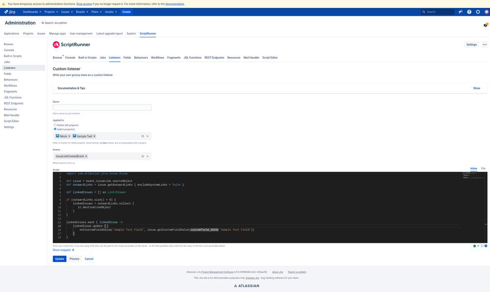

For your requirement, you could try using a Listener with the Issue Link Created Event.
Below is a sample working code for your reference:-
import com.atlassian.jira.issue.Issue
def issue = event.issueLink.sourceObject
def outwardLinks = issue.getOutwardLinks { excludeSystemLinks = false }
def linkedIssues = [] as List<Issue>
if (outwardLinks.size() > 0) {
linkedIssues = outwardLinks.collect {
it.destinationObject
linkedIssues.each { linkedIssue ->
linkedIssue.update {
setCustomFieldValue('Sample Text Field', issue.getCustomFieldValue('Sample Text Field'))
Please note that the sample working code above is not 100% exact to your environment. Hence, you will need to make the required modifications.
Below is a screenshot of the Listener configuration:-

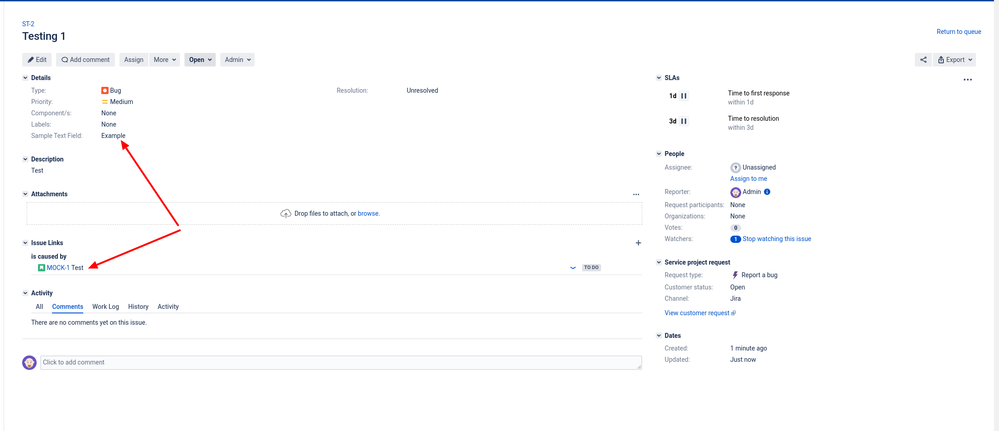

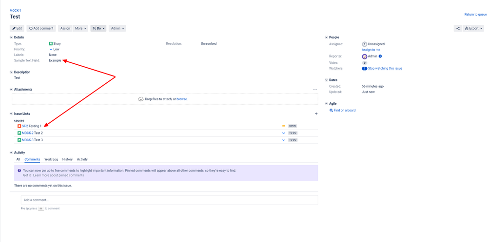

Below are a couple of test screenshots for your reference:-
1. First, I link an issue from Mock project to the Service Test project
2. Once the link is created, as expected the Text Field in the issue from the Service Test project is updated with the same value from the issue in the Mock projecttest2.png
I hope this helps to solve your question. :-)

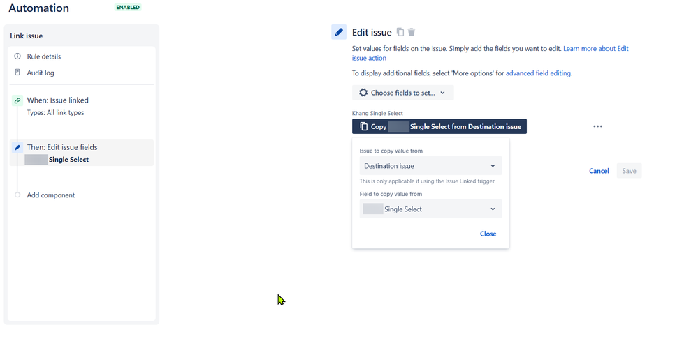

Hi @jira_admin_cu ,
To answer your question I have a recommendation,
  • Firstly, you need to create automation for 2 projects (For example A and B) set the rules like the attachment below
  • This requires project A link option is "Is blocked by" and project B link option is "blocks"
  • Custom field from project A must have value
I hope this is the result you're looking for. Thus, further research is required (apologies in advance). Good luck!
