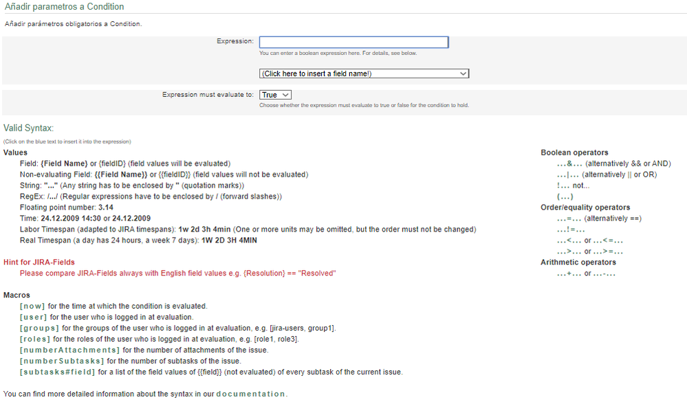

Iago Docando
November 27, 2019
for the CONDITION (not validation, sorry...) I was initially thinking of using a UNIVERSAL CONDITION. And the expression to check would be simply "your_custom_field = FALSE" or "your_custom_field = TRUE"
