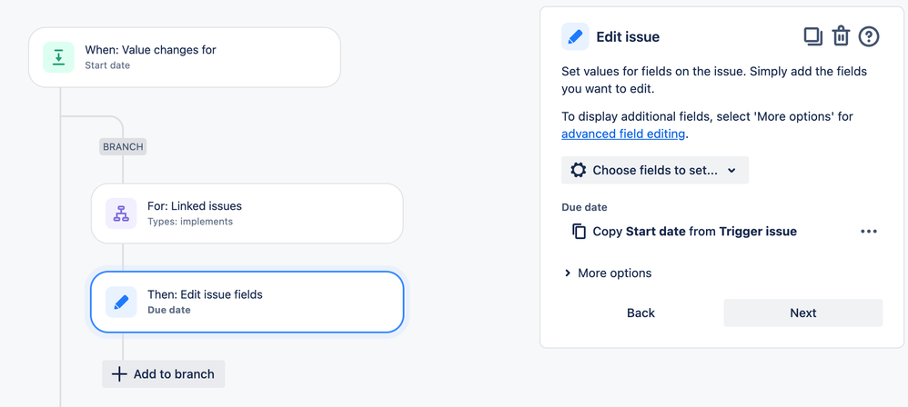

Hi @Shubham Saini
Like this :

Fazila Ashraf
January 2, 2025
yes , you have to swap the due date and start date parameters in the above screenshot and also update to the appropriate link type matching your system.
BTW, Why should this be a global rule? Does this process apply to all the projects in your site?

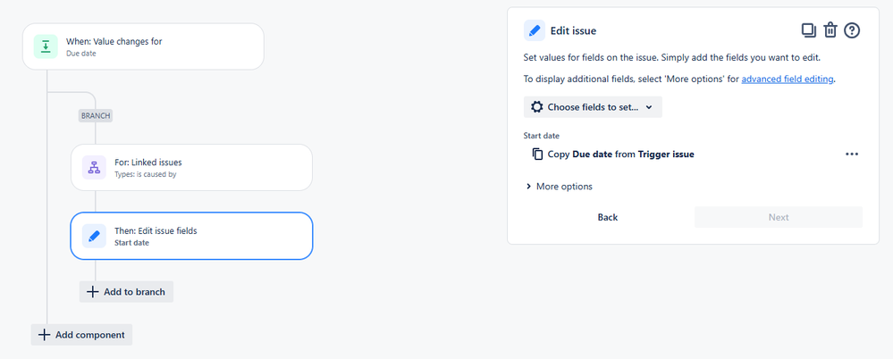

Nicolas Rigaill
January 2, 2025
Hello,
you can try something like that:
Each time the "due date" (or end date) value is updated on an issue, it will get all the tasks linked with the right link type and update their "Start date" by copying trigger issue "Due date".
