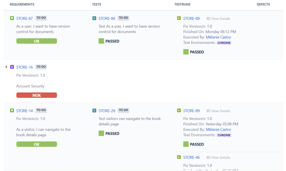

Traceability and visibility are Jira superpowers. As mentioned before, there are several apps that can help you improve this experience.
I personally like the traceability report from Xray ( Test Management), to understand Story > Test (Case) > Test Executions > Test Run > Defects relation.
Check more at: https://docs.getxray.app/display/XRAYCLOUD/Traceability+Report
