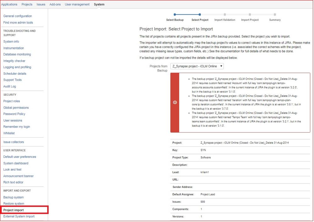

Yes, full restore you can do but not project restore between different versions of JIRA.

Dnyaneshwar Ramesh Borase
January 16, 2018
Hello Nic,
I can do the full restore from JIRA v7.0.10 to v7.3.6.but unable to do the single project import.
Got error regarding custom field require.Please find attached screenshot for your reference.Single Project Import Error.jpg
Please guide me how to minimize this error.
