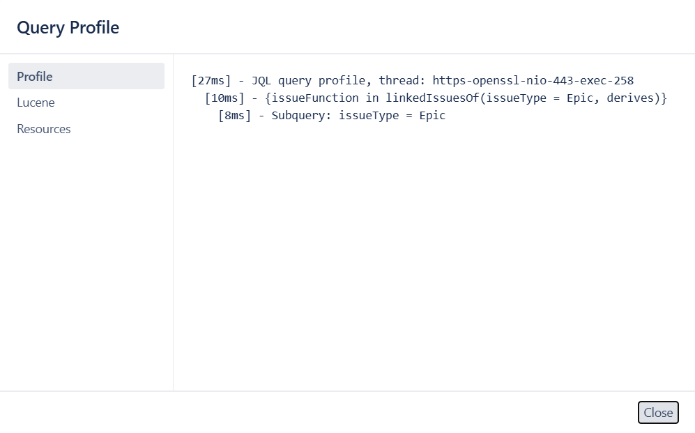

Dear Community,
Does anyone know if and how to access the JQL Query Profile shown to an admin via Java?
What we are doing:
- find any place in Jira, where JQL is used. For example, filters/search requests, custom fields, workflows, Groovy scripts, ...
- check if the JQL is executable at all -> report broken JQL to the owner of wherever we found the JQL
Since we have this already, now we would like to use the profiler as well to identify performance issues
any ideas?
Cheers,
Janek

what I am looking for is :
QueryProfile queryProfile = some.package.to.QueryProfiler.analyze( jql );
It has nothing to do with end-users being able to see this. It has to do with efficient administration, maintenance, and operations of Jira, which Jira is lacking for 20+ years, as we all know. 🤪
However, since you are right that this is a ScriptRunner feature, I will look at it's plugin source code to figure out the appropriate steps.

Janek Schumann
March 13, 2025
In case someone wants to do the same:
1. ScriptRunner for Jira is required, as Dostal pointed out
2. Undocumented REST API from ScriptRunner:
HTTP URI:
/rest/scriptrunner-jira/latest/jqlfunctions/profile
HTTP METHOD:
GET
HTTP Query parameters
jql: the JQL query to get the profile for
Return MIME type:
JSON
Example:
    "profile": "[388ms] - JQL query profile, thread: https-openssl-nio-443-exec-1\n  [71ms] - {issueFunction in linkedIssuesOf(issuetype = Project, derives)}\n    [22ms] - Subquery: issuetype = Project",
    "queryTree": "issue_id:(1 2 3 4 5)",
    "opTimers": [
        "OpSnapshot{name='issue.index.reads', invocationCount=1, elapsedTotal=387909400, elapsedMin=387909400, elapsedMax=387909400, resultSetSize=0, cpuTotal=0, cpuMin=0, cpuMax=0}",
        "OpSnapshot{name='db.conns', invocationCount=1, elapsedTotal=387914800, elapsedMin=387914800, elapsedMax=387914800, resultSetSize=0, cpuTotal=0, cpuMin=0, cpuMax=0}",
        "OpSnapshot{name='db.reads', invocationCount=1, elapsedTotal=387916500, elapsedMin=387916500, elapsedMax=387916500, resultSetSize=0, cpuTotal=0, cpuMin=0, cpuMax=0}"
Not a "nice" return structure, but I'll take it. Better than nothing.
Now we can implement something like "show me all JQL queries anywhere in Jira's configuration, which take longer than 100 ms" for performance optimization.
