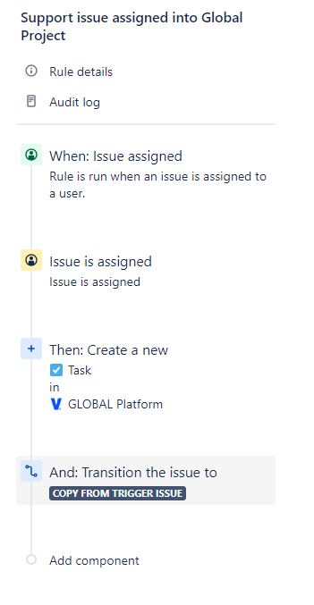

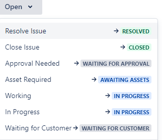

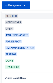

Here is a little bit more detail. We just want it to move in tandem for when the developer finishes it.  The workflow below with "Approval Needed" In the workflow is the workflow for the Service project and the one with "Q/A" check is the one for the software project.
I have attached automation. Is this correct? We basically want the support tickets to funnel to the developers and when they mark it done it then displays resolved in the Service Project

I am not quite sure it is right, but it looks close.
I assume this is in the Service Desk project.  It should:
  1. Run when an issue is assigned to someone
  2. Check that it is assigned (stop if it is not?)
  3. Create an issue (task) in "Global platform"
  4. Transition the new issue to the state the service desk project is in (if it can)
There is one problem I think - what happens when an issue in the service desk is re-assigned?  This rule looks like it will create another issue in the Global Platform project every time an issue is reassigned.
I can't see the detail in step 2, so I can not tell if you have protected against that.  Step 2 is the right place to put in a check, but it just says "issue is assigned" in your screenshot.  By definition, the rule only runs when an issue is assigned, so "issue is assigned" is always true, but what you need (and may have done) is check for "issue was unassigned and now has an assignee"
