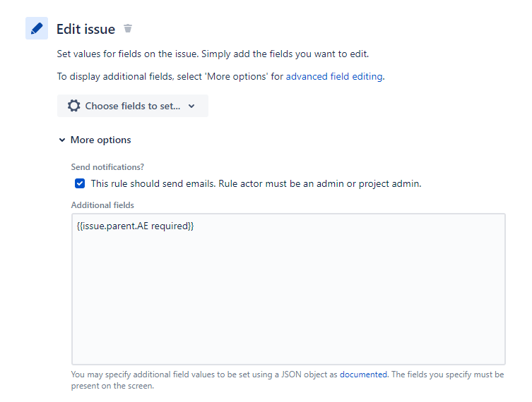

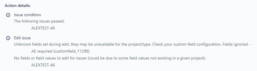

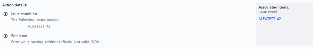

I tried what you have above but it failed creating the task at all. The tasks have already been created. We doubled back to add sub task to these tasks. I noticed the detail information was not moving over to the sub task. But with this rule above I was not able to create a normal Task.
You shouldn't need JSON. Can you please share a screenshot of the Edit Issue Action?
In the "Choose fields to set" drop-down, you'll want to select the LAE required field and cut/paste what you have in the "More Options" section there.

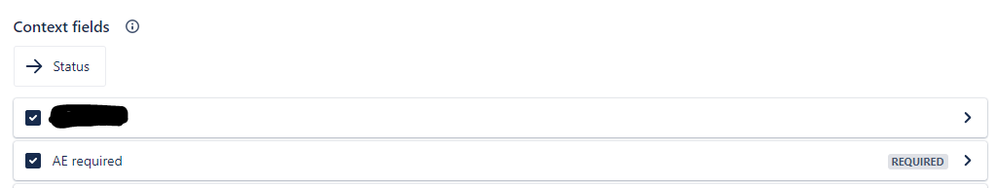

Are you using a different field configuration for Sub-Tasks vs their parent tasks? From the error, it appears that the AE required field is not available.
AE Required is a custom check box field. Does it matter if it's in the Description fields or the context fields?
Ahh checkbox field will be a little different. Replace your edit issue action with this:
{{issue.parent.AE required.value}}
I tried that as well and still it's not working... I might have to have all those done manually.
