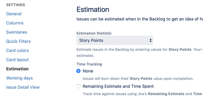

If anyone will stuck upon this problem in the future, maybe this will be helpful, as this was how it worked in our instance:
If in the "Estimation" tab in the board's configuration you have selected "Story Points", it means, that "Estimate" field on the "Issue detail view" (when you click on some issue within the Board) already shows the "Story points" value:
Therefore it's not possible to select "Story Points" in the issue detail view. But if you want to have there Story points field to be shown independently on the issue detail view anyway (like on my screenshot above) you need to do the following to add "Story Points" field to the issue detail view manually:
1. in the "Estimation" tab within the Board's configuration, select something different, than "Story points", (e.g. "Issue Count")
2. Go to the "Issue detail view" tab in the board's configuration
3. Now the "Story Points" should be able to be selected - so you can add the field to the issue detail view
4. If you want, you can change the "Estimation" back to the "Story Points", and as you already added the "Story points" in the previous step, it will remain on the issue detail view (and will look like on my screenshot above)

Hey Mark,
Could you please check if the Estimation is set as Story Points under board settings?

I'm having the same issue and my settings match what is in the screenshot above. I'm not able to see or add Story Points to the Issue Details view.
