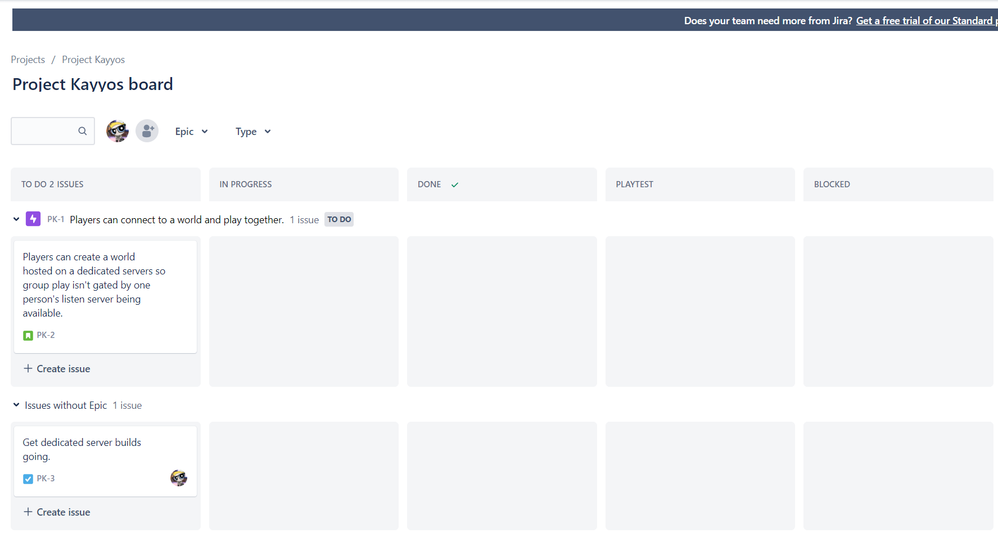

Hello! I'm having this issue where I can only see 2 issues on my board when I use the Story Mapping plugin to create Stories. Example:
I have about 30 different stories and tasks created, but only these two show up on my board. I also don't seem to have any of the board configuration options that I'm used to (I'm using the free 10 seat license.)

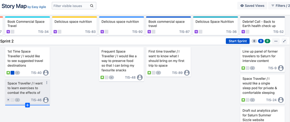

Our menu item in the sidebar looks like this:
Your Story Map would look something like this:
Hope this helps!

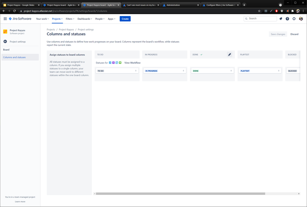

I don't have any options to change the board filter. I'm the only user on my site, I have permissions for everything, membership in every group, etc. Here's what I see:
