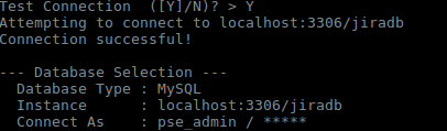

I just changed the configuration of the Jira database on my server from h2 to MySQL but I cannot access it anymore. I am directly redirected to /secure/errors.jsp. It was not the case before I change the configuration.
Any ideas?

Jira database is empty so i dont' care to migrate data. I just want that Jira use MySQL.

Karim Ennassiri
October 9, 2018
