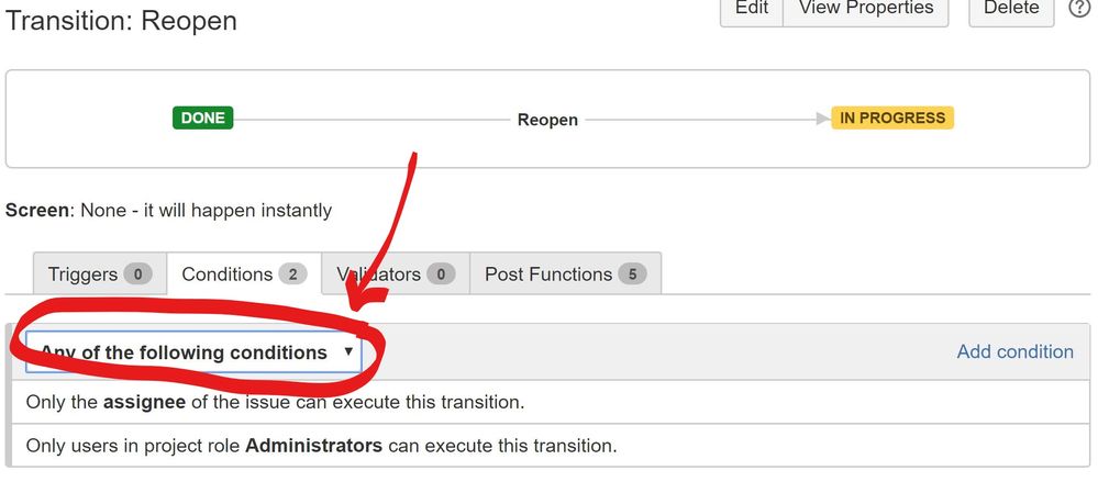

charlotte s
April 16, 2018
Hi, I have the same issue and been trying to search for answers in community but to no avail.
Transitions has a condition that only assignee and admin (project role) can execute this transition.
Permission scheme is granted to assignee and admin for move issue.
Permission scheme is granted to admin for create issue only.
Admin can execute the transitions.  But assignee cannot.  Is there anywhere else i should look at?

charlotte s
April 17, 2018
oh my oh my.....
After few days without sleep figuring this out.
I tried to install a fresh jira on a new droplet and played around permission, project roles, workflow, transitions.
I finally found it.....Thank God.
Just want to share to anyone incase they're having some troubles as well with regards to permission and condition on the transition in workflow.
When condition is set, there is a tab that shows "all of the following conditions" or "any of the following conditions".
It was set on "all of the following conditions" that's why assignee cannot move the cards.
Sadly, I have overlooked on this and spend so many hours.

charlotte s
September 5, 2018
Hi @Paul and @Rogonzalez,
Apologies for not getting back right away on your answers.  Cos my site was down and was trying to figure out on how to get it back on until I saw it was powered off in DO :)
Anyways, a screenshot is attached of the tab I mentioned on previous comment.
It should be in "Any of the following conditions" if you choose either of the Admin or Assignee can execute the transition.
But if you want both then it should be "All of the following conditions"
Hope this helps....
