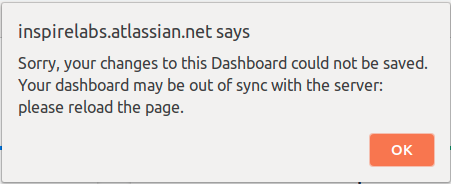

It's happend to me too.

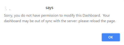

  2. I can neither move or remove any gadgets even with the administrator account, which give me a message:
    Sorry, you do not have permission to modify this Dashboard. Your dashboard may be out of sync with the server: please reload the page.

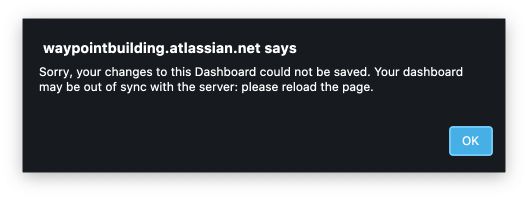

Yes me too, I cleared cache used a different browser and private window - no dice

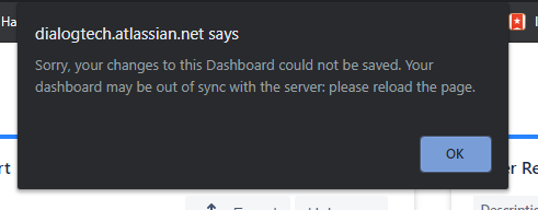

Annotation 2020-02-27 120833.pngAlso experiencing this issue in dashboards. Moving gadgets means this pop-up appears.
