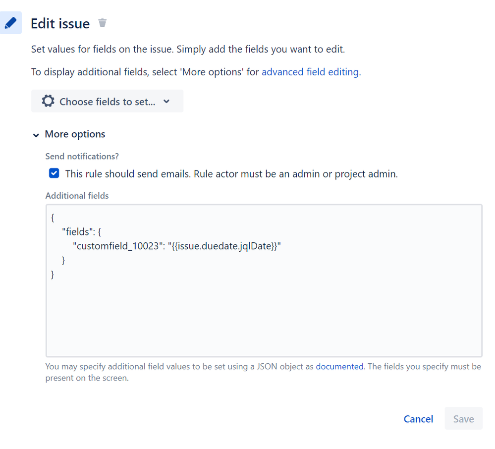

Hi @Venky ,
You can update your field like below

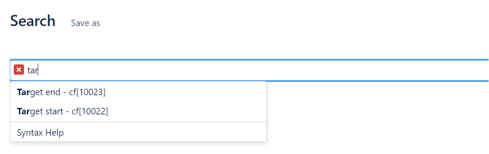

To find your field id, open advance issue search with JQL, type your field name
cf[xxx] is your field id -> it means Target start = customfield_10022, Target end = customfield_10023.
Remeber that you have to format your date value to yyyy-MM-dd, your smart value should be issue.your_source_date_field.jqlDate (your_source_date_field like due, created, customfield_xxx,...)
Hope this helps!
