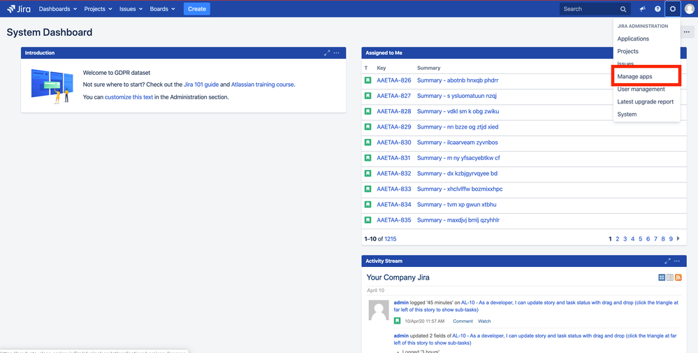

Then for Jira
1. Go to cog wheel -> Manage apps:

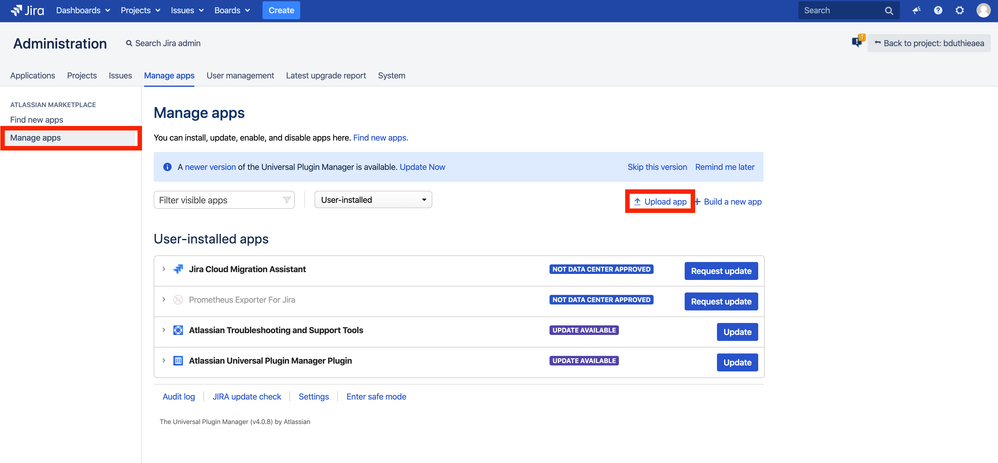

Screenshot 2020-04-21 at 19.29.30.png2. Make sure that Manage apps is chosen in the vertical menu:
Screenshot 2020-04-21 at 19.30.27.png3. Push the upload app button:

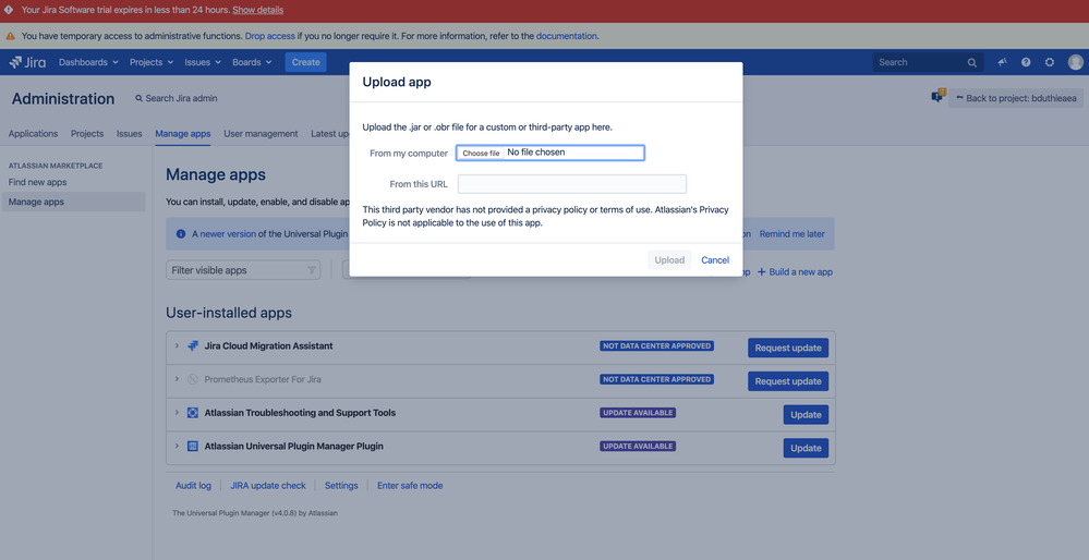

Screenshot 2020-04-21 at 19.31.01.png4. Choose the jar for Prometheus for Jira and push the upload button

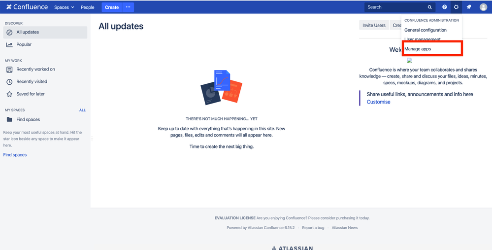

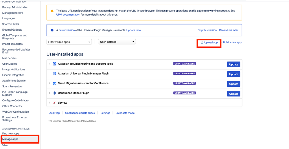

2. Make sure that the Manage apps vertical menu is chosen and use the upload app button to upload the Prometheus for Confluence jar file:
