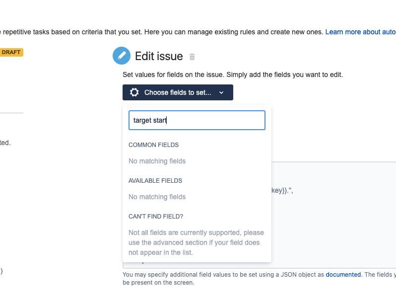

I'm trying to automate a workflow to create a new sub-task in different project when a task is created in another project. There are 2 mandatory fields in the project which are target end date and target start date. I'm not able to view them while using the edit option in automation. It is showing, can't find field, please review advance setting. My automation is failing as the target start and end dates are not captured in new sub-task

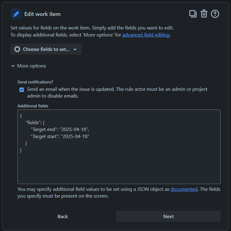

It seems you're trying to modify the Target start and Target end date fields, which are part of Advanced Roadmaps/Plans. Since these fields are system fields introduced by Plans (previously a separate plugin), they aren't directly supported by Jira Automation. However, you can still edit them using the following JSON payload:
"fields": {
"Target end": "2025-04-18",
"Target start": "2025-04-18"
Lalith Motay

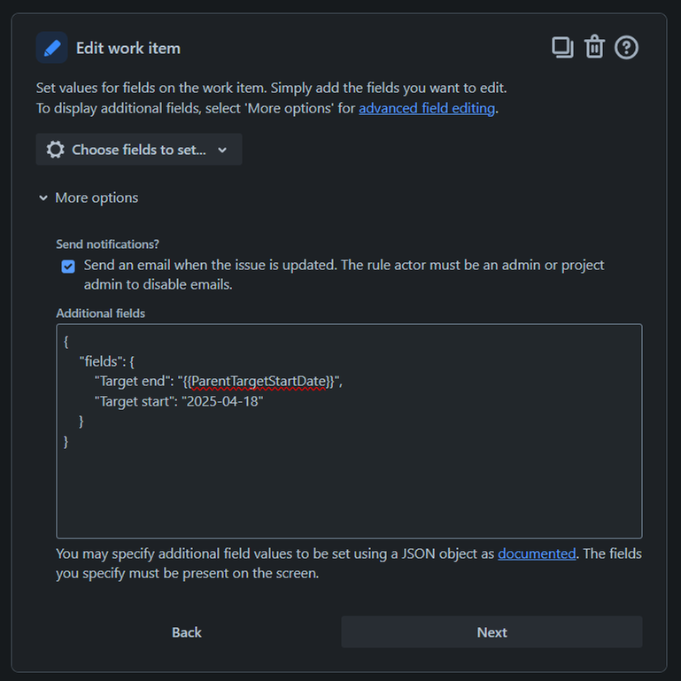

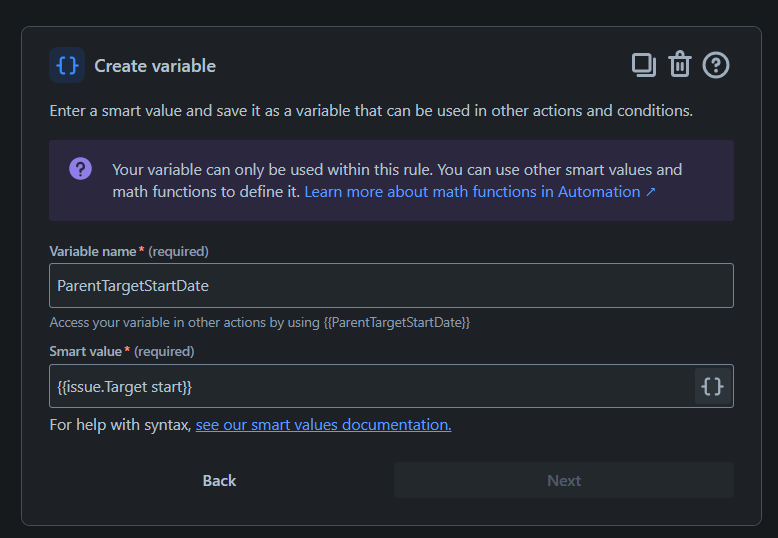

@Lalith Motay In that case, you can fetch the dates from its parent and store it in a variable. You can then reference that variable using the smart value in the json.
Lalith Motay
April 20, 2025

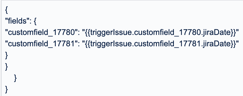

@Akash Singh - I used the below. Not sure if it works but let me know if it is right

@Lalith Motay I’m assuming that 17780 and 17781 are the field IDs for the Target start and Target end fields in your instance. If that's correct, here is the JSON you should use:
"fields": {
"customfield_17780": "{{triggerIssue.customfield_17780}}",
"customfield_17781": "{{triggerIssue.customfield_17781}}"

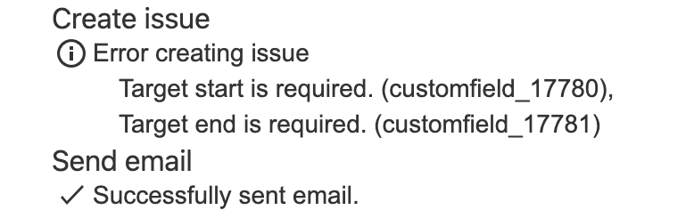

@Akash Singh There was a trigger 10 mins back and it failed with the same error.
create issue
_____________
Error creating issue
Target start is required. (customfield_17780), Target end is required. (customfield_17781)

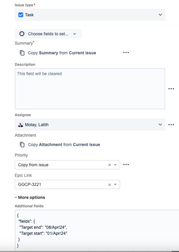

Lalith Motay
April 21, 2025
Here is the configuration info. I used a default date (format as per the custom field) but still the error.Screenshot 2025-04-21 at 7.27.29 PM.png

Lalith Motay
April 20, 2025
Hi @Trudy Claspill - Please find the error screenshotsimage (2).jpegScreenshot 2025-04-21 at 10.35.02 AM.png

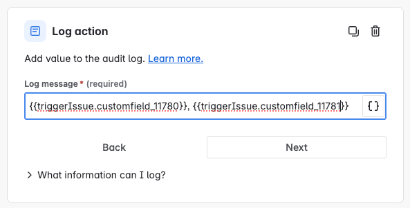

Prior to the action where you create the issue, can you add a Log action to your rule to print into the rule audit log the values of the fields from the trigger issue? Use the exact same smart values that you are using in the JSON code to set the fields; i.e.
Then run the rule again and check the log field to see what values are reported.
Also, can you provide screen images showing your entire rule? Sometimes problems are caused by the context of the actions, and debugging that requires us to see the entire rule.
