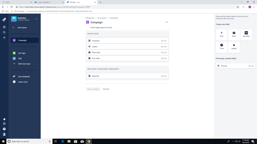

Ian Balas
October 2, 2018
This is where I'm at now. Would I just add the issue type manually? (Where it indicates "  + Add issue type")
Or am I still missing something?
Alexey Matveev
October 2, 2018
I see. It is an Agility project. You can not change the issue type scheme for this project. There are no sub-tasks for this project. You can read it here:
https://community.atlassian.com/t5/Agility-articles/Everything-you-want-to-know-about-next-gen-projects-in-Jira/ba-p/894773
Ian Balas
October 2, 2018
Right, I see now. So I guess I would have to use a different template if I want to use a custom issue type scheme? Like Scrum or Kanban?
Alexey Matveev
October 2, 2018
That is right.
