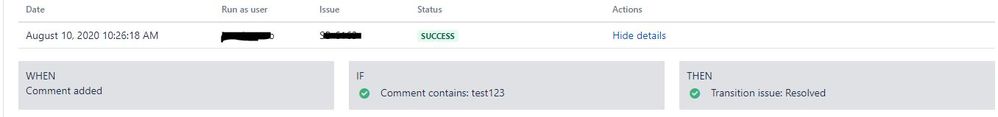

The automation log doesn't prompt any useful info.
The only thing it shows it's the "SUCCESS" action while i tried (successfully) to close the ticket via email removing my signature:
As you can see it was correctly prompted, but as i said that was the try without the signature, unluckly i can't pretend that everybody sends emails after removing their signature..! :)
