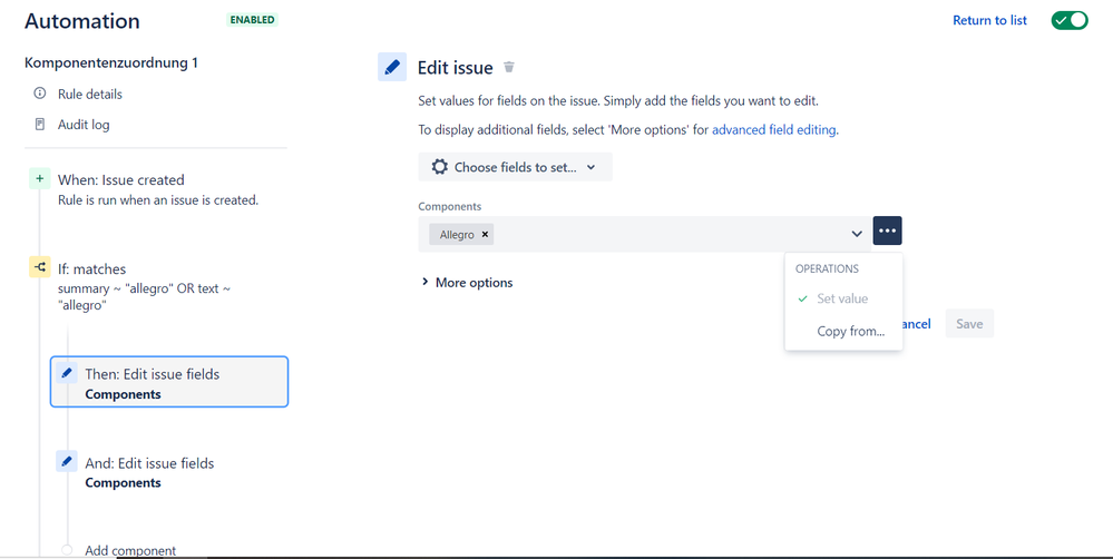

I have created an automation rule. It should add components to a ticket. But I can't choose to add existing components and a new component, so the existing components are constantly overwritten by new, when automation rule is applied.
I found on here  that there is the possibility to do so, but from some reason I can choose either add existing components or add a new component in my automation rule.
May be anyone had already had this problem and knows how to handle it

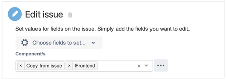

This support article describes how you can work around the issue. It is basically by adding the new component and also copying the ones that are already there. It looks like this in the example they mention:

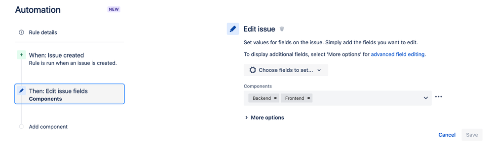

No, it doesn't. I overlooked the fact that you are trying to update your components while creating an issue. Why don't you add all components in 1 step instead of editing your issue twice? You should be able to add more than one component in a single action.

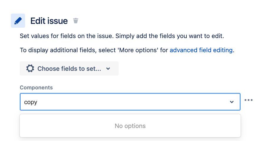

@Walter Buggenhout The original suggestion (suggested by you doesn't work).
Yes we would of course work as you mentioned, but the option "Copy from issue" doesn't exist anymore. (you can see that there have been som changes to Automation - at least in "Cloud". The naming of the field has changed from Component(s) -> Component etc ...).
So sadly the option for "Copy from issue" does not exist anymore. So do we need to report to Atlassian or do you have another workaround?

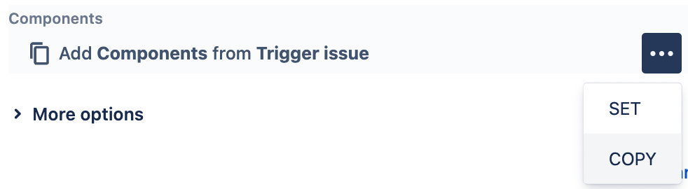

Hi @Andreas Lärkfeldt, yes it does. Simply click on the ... button right next to the field and select COPY instead of SET. Then you are able to select the source issue you want to copy from:
