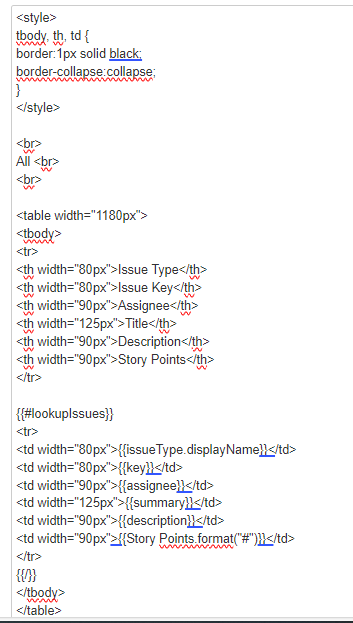

I'm building an email that sends ticket data to a user. It's a manual trigger and seems to be working just fine except for Issue Type. I can't get it to populate the Issue Type field in the table. Below you can see what I'm using for that field. I'm using the {{#lookupIssue}} function to get my tickets.
I've used: issueType.displayName, Issue Type, customfield_10106, customfield_10106.displayName, Type.name and many more.
I will put the entire code below
All
{{#lookupIssues}}{{/}}
Issue TypeIssue KeyAssigneeTitleDescriptionStory Points
{{issueType.displayName}}{{key}}{{assignee}}{{summary}}{{description}}{{Story Points.format("#")}}

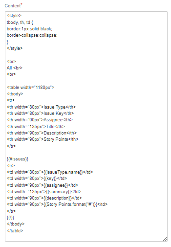

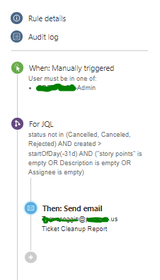

I guess everything I read online was true. It looks like the issueType field is a custom field and thus does not show up in a {{lookupIssues}} response. The way I got around this was to: branch off of the original ticket, use JQL as the "Type of Related Issues", make sure "Process all issues produced by this trigger in bulk" is checked, add table code to my email using the {{#issues}} code {{/}} to render the table.
