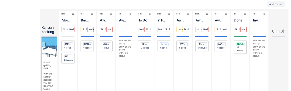

Hi I want to create a new column but the option for adding a status is not there. I believe this may have something to do with the way the board was set up, but can anyone confirm what it is I need to change in order to add the status?
As you can see from the screenshot, the column won't show without a status. But from what I've seen online, the option to add a status should be at the top near 'add column' - which it isn't here.
What do I need to do to add a status to these columns? Screenshot 2021-05-27 at 08.42.02.png

Hi @Emma O_Gorman and welcome to Community!
To see the "Add status" button on a board, you need to be:
  • admin of the project
  • working on a simplified workflow board

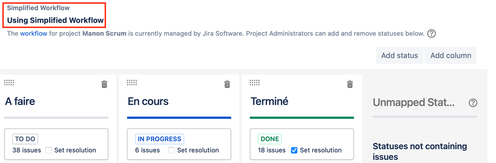

You can check just above the columns if you're using simplified workflow:
Hope this helps,
- Manon

Also, you should check the difference between simplified and Jira workflow here: Using the Simplified Workflow

Thanks @Manon Soubies-Camy that's really helpful.
I had a look at the differences and apart from the new column I don't want the simplified workflow preferably, as I want movement between columns restricted to certain ones.
Do you know of any other way to do it? The columns which exist already are not just default ones, so I presume they were added by a predecessor somehow, I just can't figure it out!
