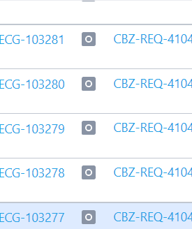

Aneeka
February 15, 2022
I searched with
project =xxxx AND type = Requirement AND issueLinkType != EMPTY AND issuetype != Story
result was -   list of all issues with type requirement ,
when I open some of them , I get
in linked issue -
issues which are tagged as story and other issue like requirements, change request .
Pramodh M
February 15, 2022
Yeah for the linked issues of type Story we need to use Scriptrunner add-on or JQL for extensions
