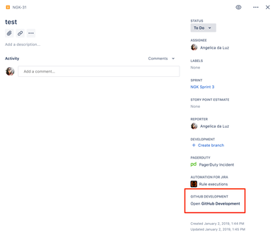

Where does it appear? I just setup GitHub integration and I see nothing different about my board or issues.

Hi @Mick,
When you open a ticket on the board, it will show the "GitHub Development":

Hey Angelica, sort of an old post but I can't seem to see that option on our jira (cloud version). Can you confirm next-gen projects should be able to see that github development section? (other regular projects on Jira have the integration working correctly).

Angélica Luz
June 12, 2019
Hi Ricard,
Yes, Github works with next-gen. Please, install both add-ons GitHub for Jira and Create GitHub Branches from Jira and after configuring, the development panel should appear.
If you face any issue, please let us know!
