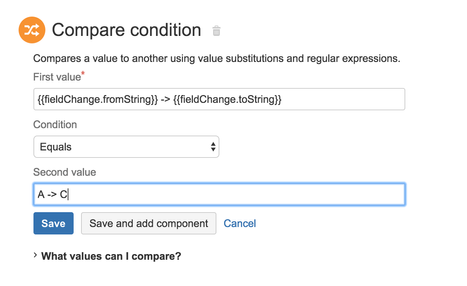

Hi Sebastián,
To do this you can create a rule with the following:
It should look like this:
The value for the First field is:
{{fieldChange.fromString}} -> {{fieldChange.toString}}Hope that is what you were after.

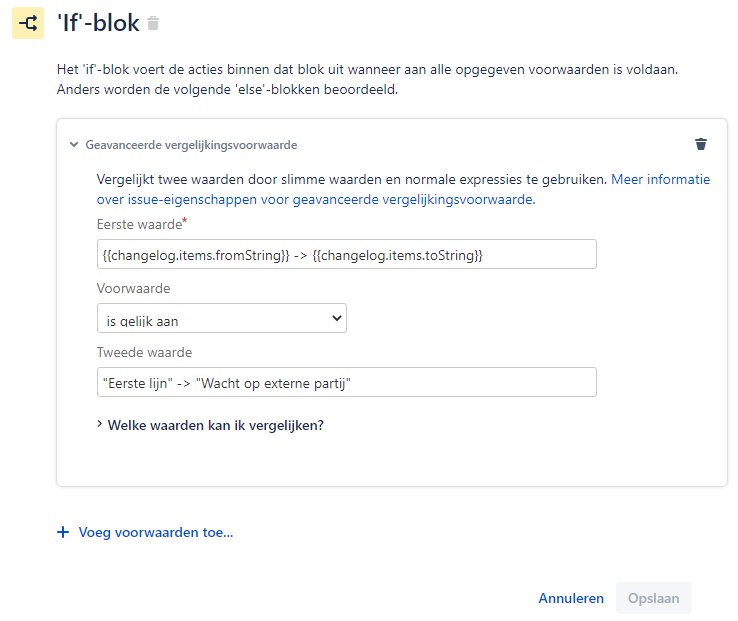

Hi,
I have the same problem as described by Sebastián. As stated by Jim I used the new webhook. Unfortunately I can’t get the advanced compare to work. Below you find a screenshot of what I have so far.
It is in Dutch but I hope anyone can point me in the right direction.
Thanks in advance.
Anton.
Hi,
I read on this page that {{changelog}} will not be populated if you use the wrong trigger.
So that basically answered my question.
