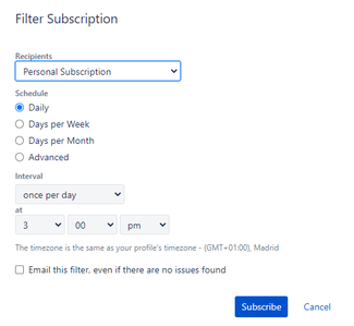

You could make a subscription to the filter for a certain group, this subscription would arrive by email to the person you include in that group every day (or when you schedule it).
To do this you must navigate to the filters, click on the three points and select "Manage subscriptions", then click on "Add Subscription" and indicate the group to whom you want to send the report and the period in which you want it to be sent.
In this way you would have automated reporting and sending to users.
