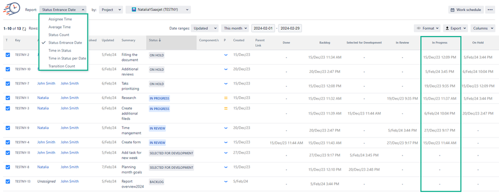

If you are open to try out mktplace app for this need, take a look at
The Status Transition Dates report can help you meet this use case as shown below. You can also export this data to a csv file or a JSON feed which can be used in a BI tool like Power BI.
The app is free for 10 users. Do try it out.
Disclaimer : I work for RVS, the vendor for this app

Hello @Hans van Rijsewijk ,
Welcome to the community!
You are correct, the required data is available in each issue's history but you will need to use a marketplace app to get ready-to-go reports. Good news that report is available in our application where you can directly learn the transition dates without having to deal with Jira issue histories. The app is Timepiece - Time in Status for Jira , the oldest and leading Time in Status app in Atlassian Marketplace, which is built by my team at OBSS. It is available for both Jira Cloud, and Data Center.
You can use the date-based reports to see the transition dates from/to a status. In the screenshot below you can see the transition dates of the issues to each status. I think this report will be spot on for your needs.
Visit Timepiece - Time in Status for Jira to explore and enjoy a 30-day free trial to experience the full range of features.
If you wish, you can also schedule a live demo. We will provide a comprehensive overview of the application and address any inquiries you may have.
Hope it helps,
Gizem
