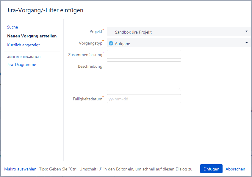

Result of the Configuration:

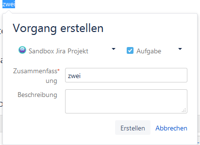

- Create Jira issue by highlighting text has no changes and does not work anymore, that means i can not add Issues to Jira after the Field Configuration.
- Create Jira Issue by Edit Dialog (see screen) has my changes and I can add an Issue with my custom datafields.
If i cancel my configuration in Jira for the Field "Fälligkeitsdatum" i can use Create Jira issue by highlighting but without my custome DataFields.

Which changes did you do specifically?
If you want to make a field visible in the  Create Jira issue by highlighting you just need to make this field required. Is that what you did?

Yes, this is exactly what i did.
But I see in Your Screen that it must be work. I will try it again with a fresh Instance and write back.
