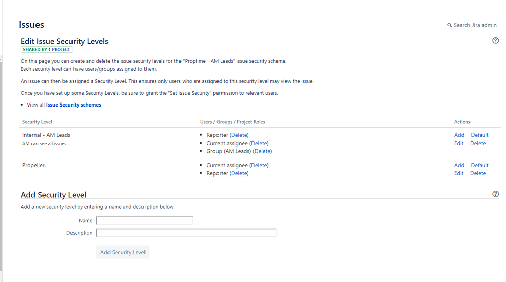

So I have created a Security level shared with the project
Internal - AM Leads - Reporter, current Assignee & Group AM Leads
Propeller - Current Assignee & Reporter.
I have created the option to show the tickets but if someone is creating a ticket that is not a lead they are seeing other tickets. Is there something i have missed?

Dear @Ravi Mistry ,
Press the link "Default" for "Internal ...". Then, you enforce that every issue as a security level.
Note: The "Propeller" will lock out your leads. _Is this what you wanted?

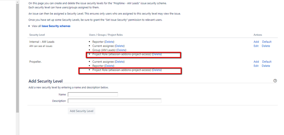

Ravi Mistry
February 24, 2020
Thomas Deiler
February 24, 2020
Possible but you screen shit shows something different,
Propeller: Assignee + Reporter + Tech Lead
Internal: Tech Tead
Default should be "Propeller" and Tech leads can change the security level to "internal" which makes it invisible for reporters and assignee.
So long
Thomas
Ravi Mistry
February 25, 2020
Thank you Tom this has worked!
