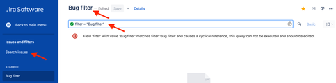

Additionally, make sure you are not running the filter over the same filter since it will cause a cyclical reference. Explaining better:
Ensure that you are not running the filter query when editing the same filter referenced in the query, like in the screenshot below:
That been said, ensure you clicked on Search Issues option to perform your search, and not in the filter itself.
